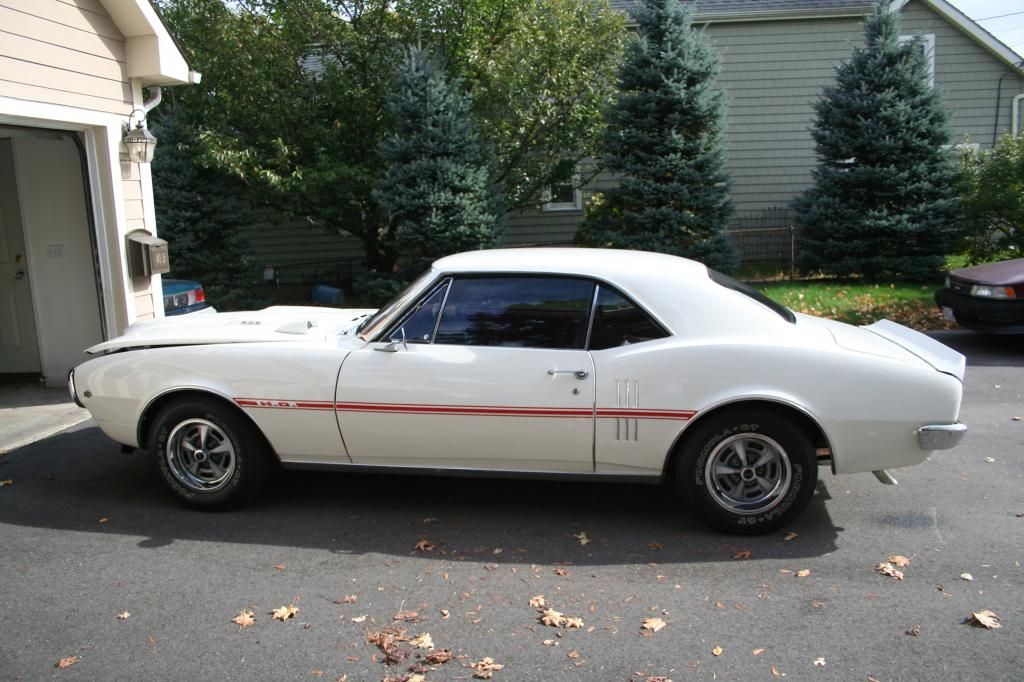

Hello, I'm new to the forum and to firebirds as well. I just picked up a 400 coupe. The car has undergone a fair to pretty good restoration and was represented to the previous owner (who took it in trade for some land) as an original engine car. Now the " interesting" part, neither he nor now I can figure out why there is a YS coded block in the car. What is more confusing is that there does not seem to be any stamping down where the block vin # should be. I stripped the paint to bare metal from the radiator hose down and can't se anything I'd call a number. Is it possible that a dealer would put a replacement block with a YS code into a Firebird? Any insight woulD be GREATLY appreciated!!!

#24 ·
Looks like a good project. You’ve got your work cut out for you. Also looks like an interesting Bird in the background.
Thanks for the photos.
Thanks. Yeah, this needs some work but is a more solid than the last two cars I built.
