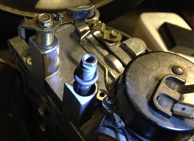

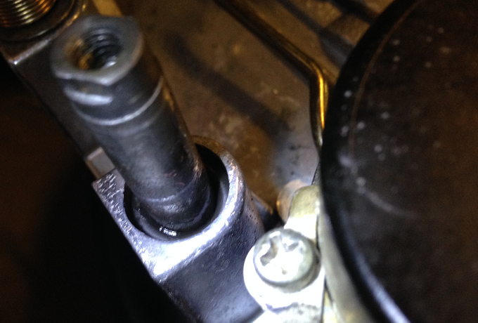

Okay. This is not the whole story. The carb - Edelbrock 1406, took it apart, dipped it in Berryman, washed cleaned - still no idle (I already had fuel tank removed, washed out, hoses blowed, etc) Went through the carb a second time - still found some more grime washed out and then noticed that shafts are pretty worn out, especially on the opposite side of throttle linkage. So naturally it should be the source of vacuum leaks. I know I should just get a better carb but I wanted to get this one up and running with minimal investments because I have not yet decided if I should stick with Edelbrock at all. So I used some rubber orings to seal the shafts and that helped alot (had some old bottom orings from BMW 3-series injectors and those fit nice with some minimal alteration, see pic).
