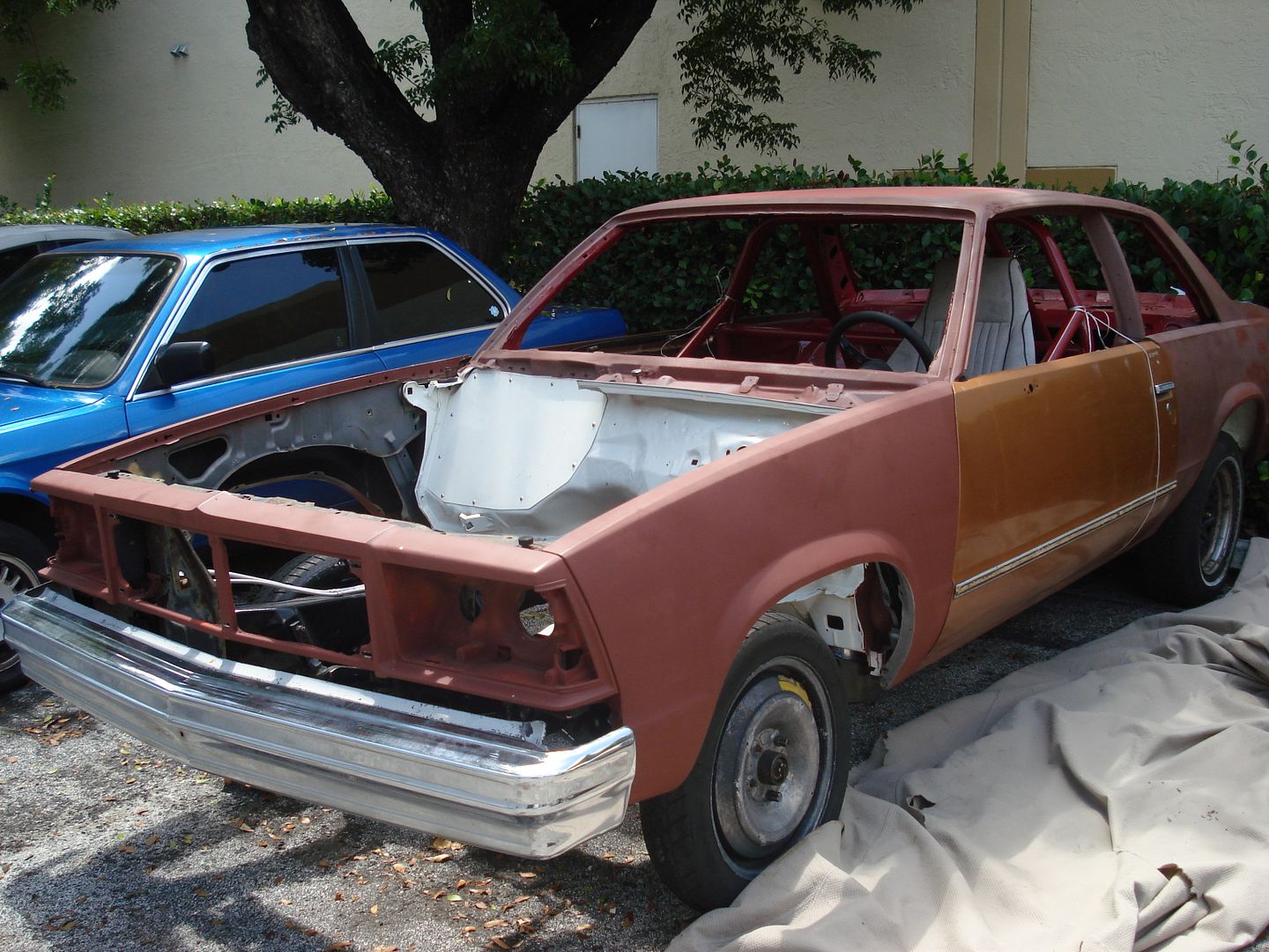

Back in the mid 70's I had 14" Pontiac rally's on a Camaro with the old tire sizing F 70 fronts and G 60 rears if I remember correctly. Pretty sure they were 14 X 7 rims from a GTO or something like that. Most of the 14" Rallys were 6" if I remember correctly. I've been building an 81 Malibu for several years with a kind of backdated look. I'm running 14" Chevy Rallys on it.

And that's what it'll get used for along with perhaps some auto X. I originally gave it a refresh and quick paint job back in the mid 90's and used it as a DD with the original 6 cyl drive train. 10 years later I did a more thorough body job along with new paint and this time it's getting a 10 bolt rear with 3.73 posi, 355 SBC I've been building, and a T-400. I've got a set of Centerlines sportin ET Streets with skinnys up front.for the strip and will probably run A6's for auto X. Have a full Hotchkis suspension with bags, full Flowmaster exhaust, and a bunch of other goodies ready to install. I've also gotta install a new Landau top but I've got to get my bird back on track first. I promised myself I won't project jump.

They used to be plentiful but around here they are actually getting hard to find in decent shape. I'd take a gutted one as long as it had straight sheet metal and was a solid roller. They are pretty light for their size.
#7 ·
I had a few of them when I lived up North. Had a nice 78? 305 bracket/street car but is wasn't fast enough to keep me entertained. I had the perfect 79 for you here a couple years ago and sold it cheap. I bought it as unfinished project and flipped it. At one point I had molds to make fiberglass hoods/decklids for those cars. I still keep an eye out for the old diesel G bodies hoping for the rare aluminum pieces.
