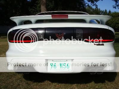

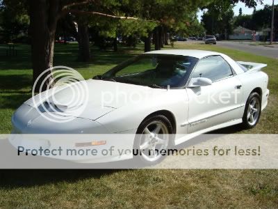

Off topic but once again both Evan & Russ caught my eye with the white birds. I almost bought a white 99 but went for the black 01. Nice cars guys. sharp/clean looking.

Thanks. Russ has more done to his and mine is still bone stock. :ditto: lol ( i hope we could help some Amy)
