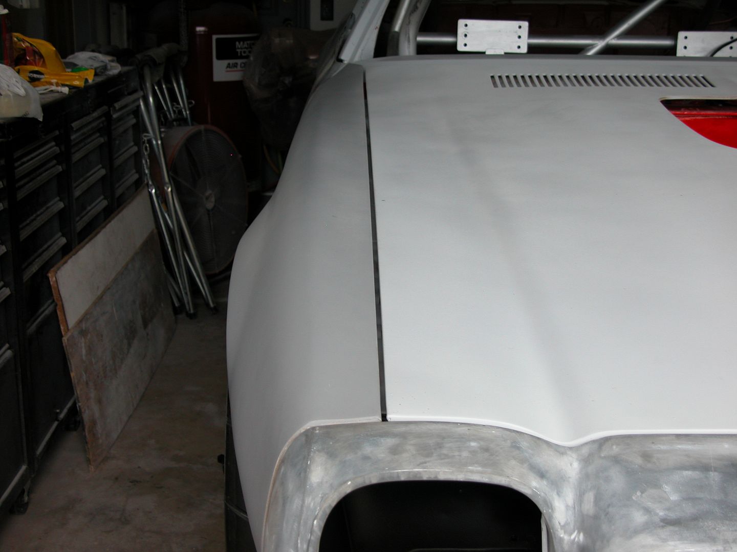

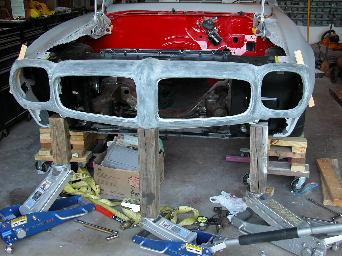

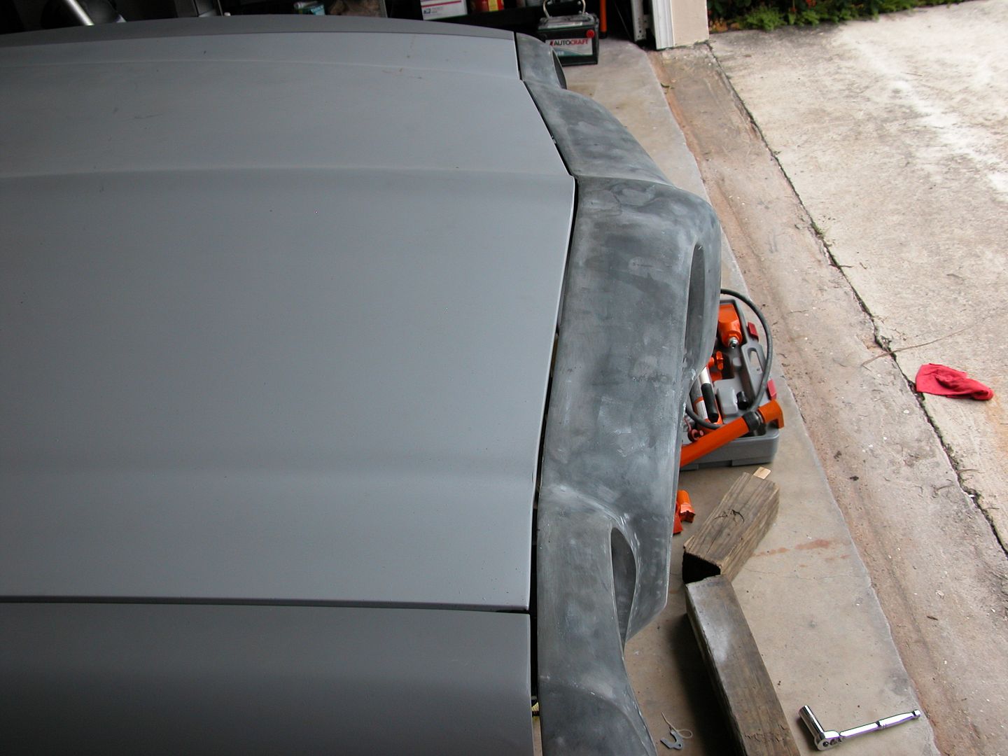

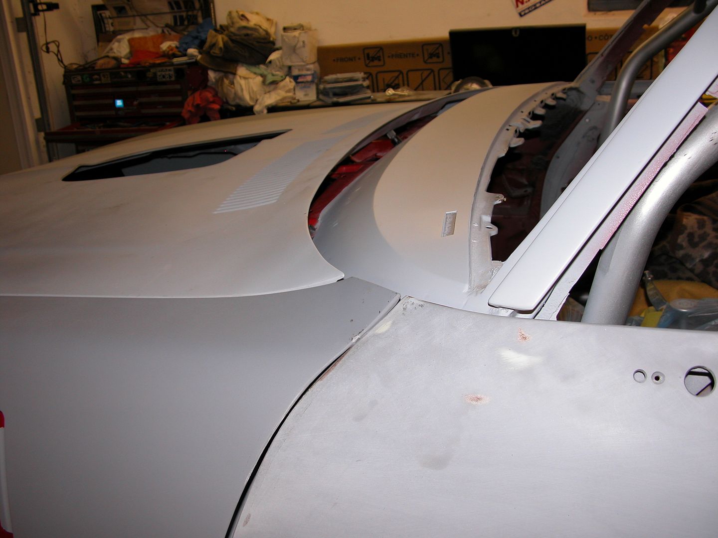

Dustin: Bumper, bumper supports, and splash pan have to come off no matter what to swap subs. If you remove the engine then you'll only have to remove the hood, splash pan, bumper, and bumper brackets. You could leave the fenders and core support in place theoretically. If Speedtech is using the later frame design to base their new frame specs from you'll need to modify the core support body mount holes and use the 1" part of the solid body mounts for the core support to space the core support from the frame so the bumper brackets will end up in the correct height zone and the core won't push the front of the fenders up. The early 2nd gen core support factory body mount holes are smaller than aftermarket solid mounts made for 70-81 anyway so no matter what you'll be modifying the holes to use good solid mounts.
The horns on the later frames are about 5/8" wider at the front where the bumper brackets mount. So most of the side to side bumper adjustment the factory provided is taken up by the difference.
If the body shop aligns the fenders etc. now with old deteriorated subframe bushings you'll probably end up having to realign fenders anyway. That's another reason why I mentioned just waiting for final paint till after the new sub is installed.
The one I posted the vid of above was a 78 loaded subframe into a 81 unibody.
If you have the body guys align the front end now show them these pics unless they're well versed in 70-73 bird front panel alignment. Then they'll understand why they can't have the bumper touch the fenders and how to support it while adjusting the bumper brackets. Don't let them give ya the "Don't worry we know what we're doing" thing because most body shops now have no clue that the bumper is supposed to have a gap to make all the panels align correctly. The guys that fixed these cars as techs in collision shops when they were new are at least 60+ years old and moved on. Most people try to have the bumper touch the fender because they just don't know. Thats why you see 3/4 or more of 70-73's with the bumper touching the fender and the other panels not quite lining up.
